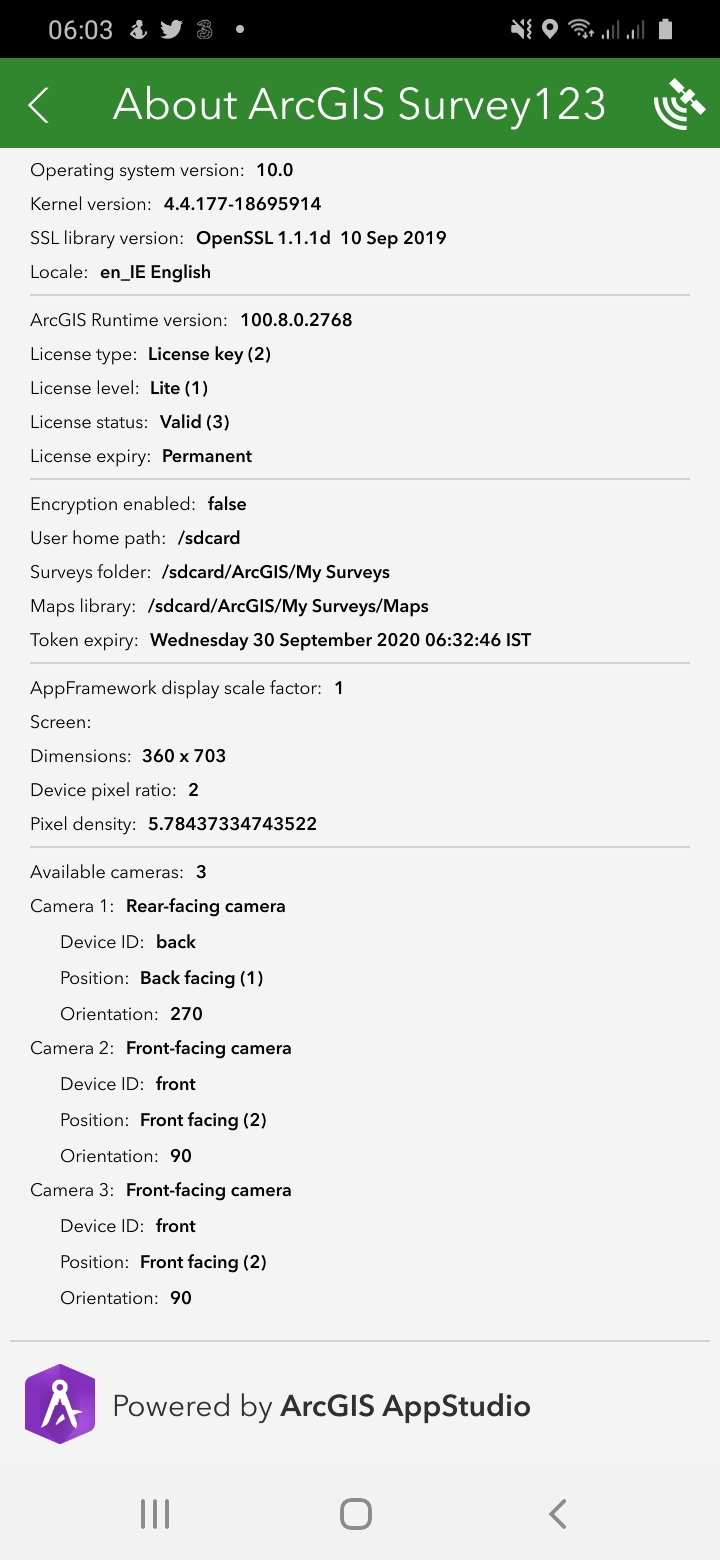

PaulSweeney3
Hi Philip
My device  is reporting 3 cameras
Thanks

Hi Paul,
Thanks, that is very helpful. We are working on a fix and should have it available for the upcoming 3.11 release. Once It is available on Early Adopter Community you can test out the 3.11 RC2 builds if you want to try it earlier.

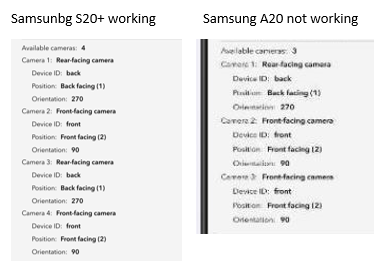

Hi Marcus,
The problem appears to be related to the number of cameras being reported by the device, in some cases there are 4 cameras (2 front and 2 rear cameras) but in other cases there are just 3 or 2 cameras. The device treats this hardware as one camera front and back, but in some cases where 3 cameras are reported it is causing the camera switcher to try and access them individually as if they are separate cameras. We managed to test on a A20 and see the issue reported.
Can you please take a screenshot of the About screen in the Survey123 app, press and hold on the AppStudio icon in the bottom left hand corner to expose more details and then scroll down to the camera section. It should look similar to following screenshots:
I just want to check how many cameras are being reported on the device you are having issues with.

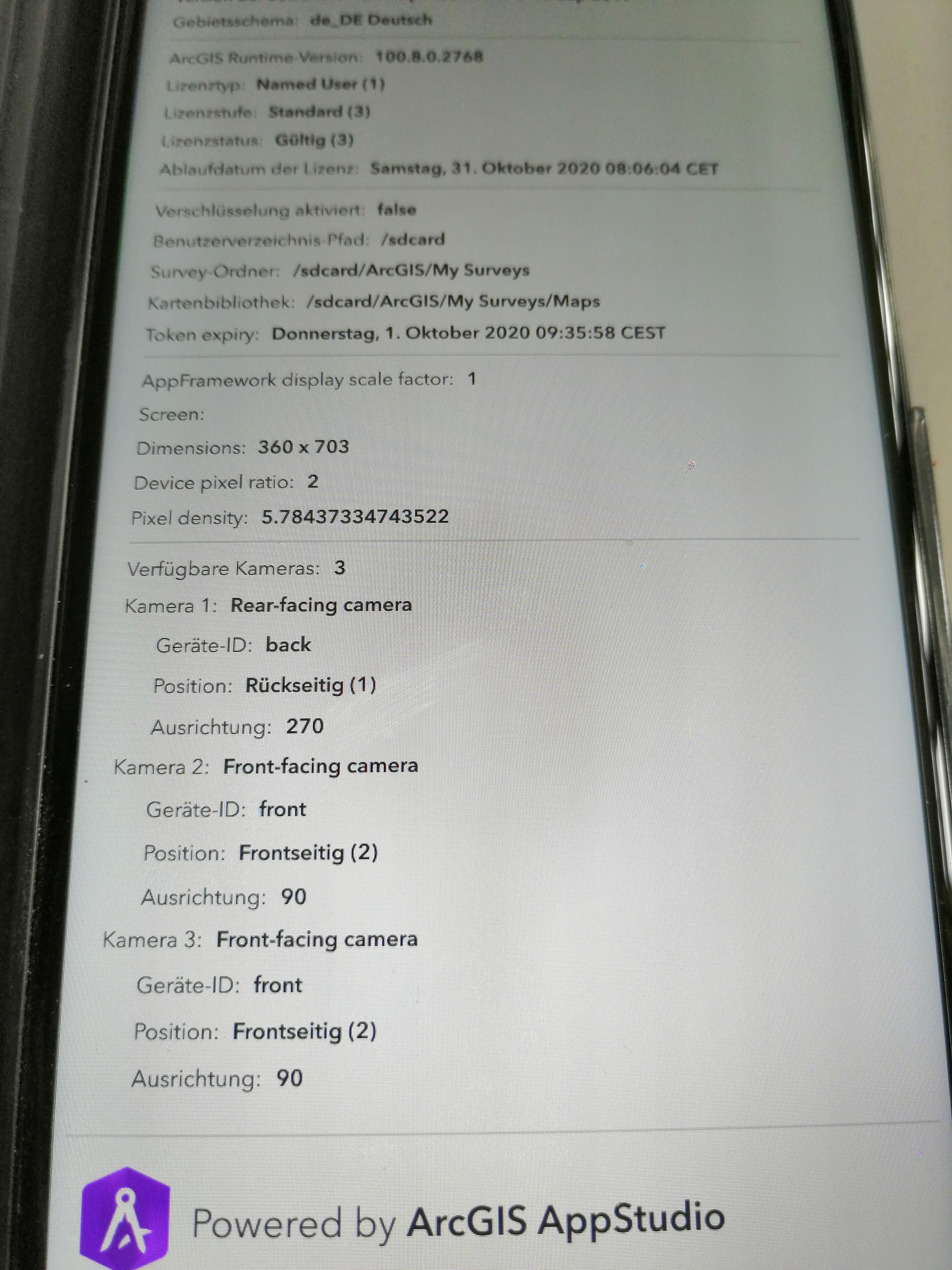

MarcusSeuser
Dear Phil,
thank you very much for your help. Our device is also reporting 3 cameras (see screenshot). Any help with the problem is very much appreciated 😃

Hi Marcus,
Just letting you know the issue with the camera switcher on some Android devices that you reported above has been fixed and will be available in the 3.11 release. You can test out the fix with the latest 3.11 RC2 builds now available on the Early Adopter Community.
