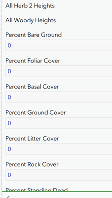

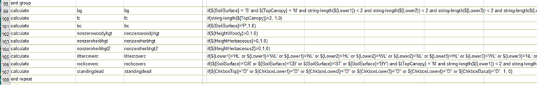

DougBrowning
MVP Esteemed Contributor
Here is an example
Inside the repeat
Then outside
I can get you the form ready to go just lmk.
DougBrowning
I have a advanced LPI form that we have been perfecting for 5 years now. Reach out to me if intrested.
We do some summary calcs in the form for the users as you describe.
If you have a repeat like us you have to double count.  So inside the repeat and then again outside the repeat.  Pretty hard to explain here so each out to me.
