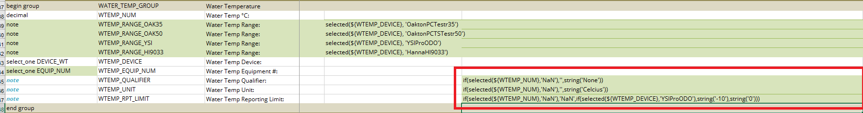

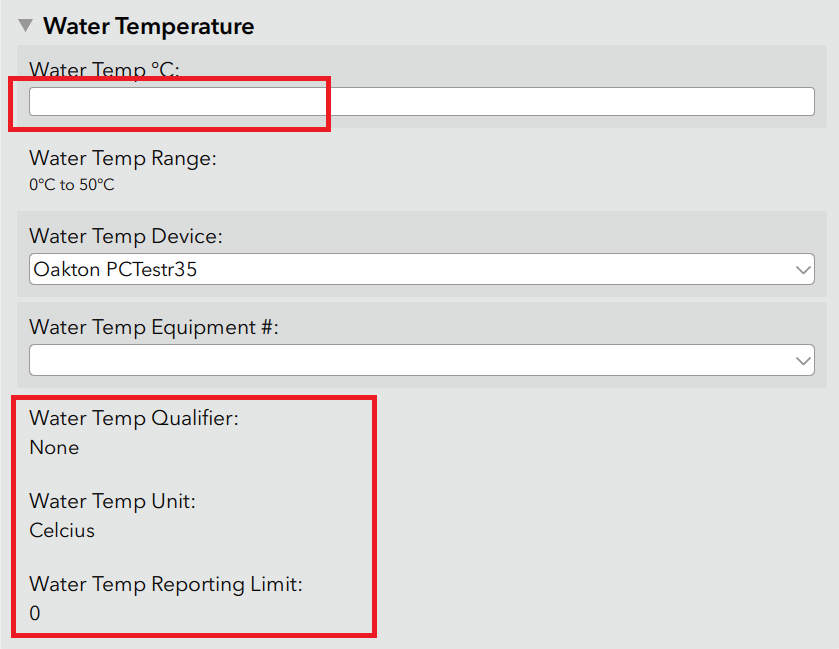

Hello,
I am trying to write a calculation and I can't quite get it to work.
I have attached a couple screen shots to help explain what is going on.
The calculations I have written do not create any errors yet how the survey is filled in or rather not filled in, the answers to other questions appear when they should be null.  There are no defaults populated other than for Water Temp Device.
if(selected(${WTEMP_NUM},'NaN'),'',string('None'))

KatherinePadilla
So the referenced field WTEMP_NUM is a fill in decimal type.  The calculation I would like to make is this:  if WTEMP_NUM is null (not filled in), then the WTEMP_QUALIFIER shall be null, otherwise it shall be None.  I am also trying to make some relevancy statements referencing this filed as well that are not behaving as desired.  I am not sure if these types of statements work with this type of field (fill in decimal).  Perhaps there is a different way to reference these types of fields that will get the desired outcome?
KatherinePadilla
I did try to use an intermediate step that used the string-length function to calculate the 0 or 1 then referenced that field in the equation and it still did not workout as expected.

IngridAldridge1
Hi Katherine,
The selected() calculation only works on the select_one or select_multiple question types.  For a decimal it is better to look at the length of the response.  For example: if(string-length(${WTEMP_NUM})>0,'','None').  This will look at the length of the response for your field ${WTEMP_NUM} and if it is greater than 0 i.e. filled in with anything it will give you a blank response '' but if it is not filled it will return the work None. A variation of this should also work in your relevancy statements as well.
KatherinePadilla
This works out well.  Thank you!!
