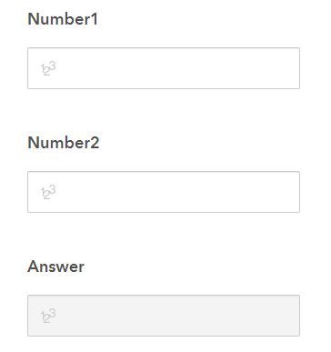

@Anonymous User I was not able to recreate your issue using the web designer and version 3.15.159 of the field app. I made a simple survey as shown below with two inputs and a read only calculation subtracting the second input from the first
I then found I was able to edit the numbers and via sent / outbox / draft and the calculation updated.
Are you able to test on a simple survey? Like mine. Does the issue still occur?

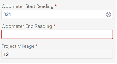

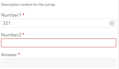

thanks @Richard_Purkis , I did what you mentioned and you are right it does work for all of the above
and also I did ensure we are using the same version of the field app (3.15.159) and also republished the survey with the issue in question so it is also published with the latest info and still the problem persists
one note that maybe can help pinpoint the issue:  in the simple survey when I delete either entry (Number1 or Number2) the calculation field empties and once a new entry is provided it recalculates, however in the survey with the issue when you delete either entry nothing happens to the calculation field (see two screenshots below), in simple terms it seems to be "stuck" with the original calculation, I reviewed all the settings applied to the questions (required question, must be integer, etc.) involved and made them match and as noted the simple survey still works fine but the actual survey problem still persists
