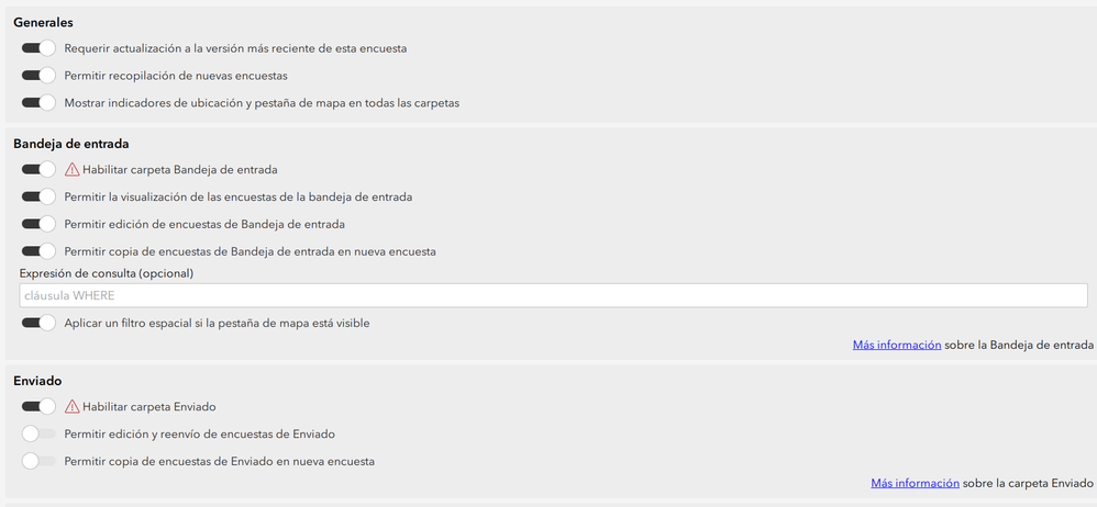

VerleyAltamirano
Sure, here the images and survey

Hi @VerleyAltamirano,
I notice you have both the Inbox and Sent box enabled at the same time for this survey. Note this is not advisable, as will mean that Inbox records do not get updated when the Inbox is refreshed, if they are already on the device in the Sent folder. In this case please disable the Sent box to avoid this issue.
Are the first and second user using the same device, or using different devices? Do they refresh the Inbox before they edit the record?
