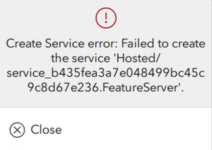

1. Can you go to Portal for ArcGIS > Content > Add Item > Feature Layer?
  • We tried adding an item in the Portal and it resulted an error below.jantolihao_0-1665453555288.png

This is not a Survey123 issue. Something is going on with your ArcGIS Enterprise environment and should be impacting all users and apps.
Not sure what your position is here but this will need to be investigated by your IT/GIS administrator. Start by taking a look at the servers machine, validate ArcGIS Server, ArcGIS Data Store, check certificates and network traffic. Check ArcGIS Server logs. Depends if this is a new setup or existing.
