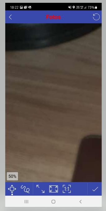

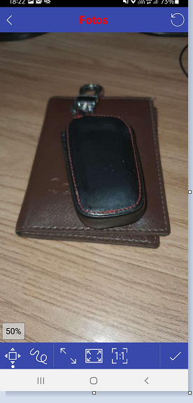

I have configured the xlsform (apperance column) to "multiline annotate". And it works fine. I can take the picture and do annotation, but when I confirm the photo is cut. Any idea what is wrong.
... taking photos
... after confirmed button
I have ajusted all zooms and no success.

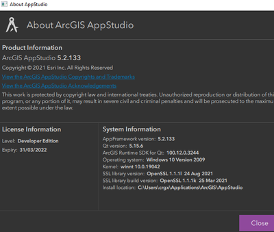

Can you please confirm what version of field app you are using, and what make/model device and Android OS version?
Also can you go into the Settings menu, and About screen, press and hold on the AppStudio icon at bottom to expose all details, and then screenshot the AppFramework display scale factor section.

I am using the AppSutudio 5.2.133 version. I have created an application from Survey123 template.
I am taking a photo in build camera, save and back to the form. Yes, it shows 1/4... of the image. And all photos are cut.
