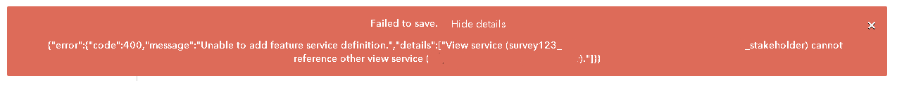

I have a survey that uses the submission url parameter to direct data to a hosted feature layer view. I want to provide access to the data through survey123.arcgis.com but when i go to Collaborate and select the group I want to share the survey with I get an error saying  'view service cannot reference other view service'. Does this mean I cannot make the data available through the survey123.arcgis.com website to viewers?
Thanks,
Finniansurvey123.arcgis.com enable viewer error

At this time you can't share for analysis (make available via the Survey123 website) a survey that uses submission_url pointed to a view.
