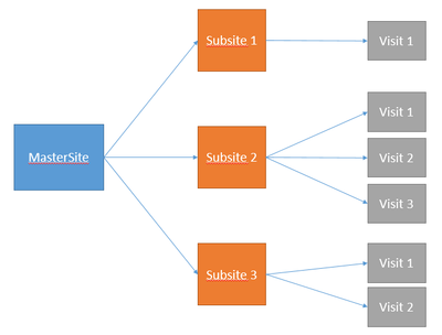

Hey everyone, I am stuck trying to figure out the best path forward for a particular nested repeat inspection workflow I have:
Basically, there are "MasterSites" (geopoint), each master site can have several "Subsites" (nested geopoint), and then each subsite can have several "Visits/Inspections" (nested table within subsites).
  • MasterSite (fields containing general master site info, geopoint)
    • Subsite (fields containing general subsite info, geopoint)
      • Visit/Inspection (inspection table)

I would break it into 3 feature classes then use Field Maps forms or 123 form for each depending on how complicated they are.  Then use relationship classes to tie the 3 together.  You could send the location down the line but I like to have the real location where they went.  For example what if they filled out an inspection wrong?  You can see this easily spatially if each has their own GPS.  Just send the main key to each form then they are all related.
