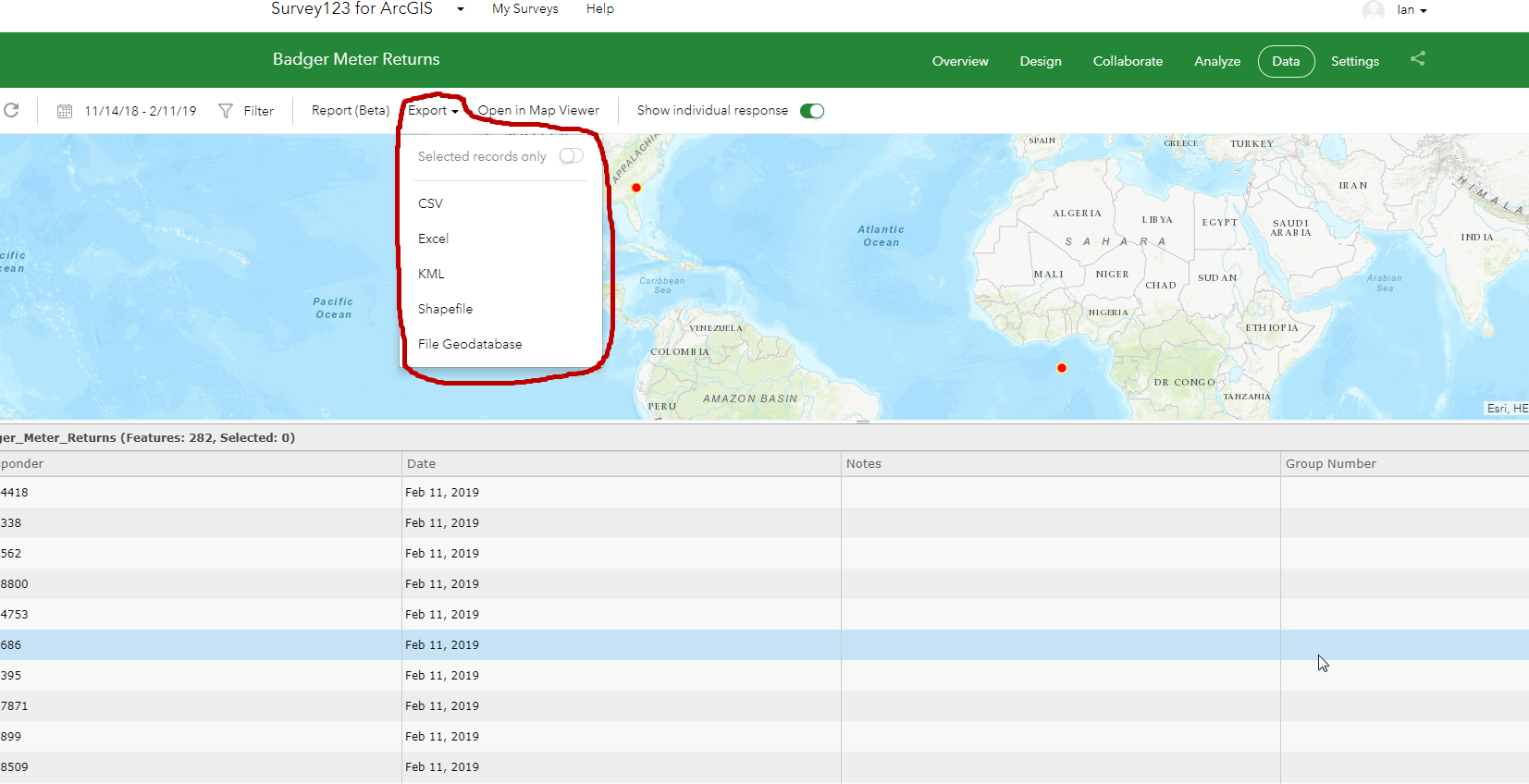

I can download an excel from Survey123 data, but one of the other members of the group cannot.
I am at Administrator level, the other member is at Creator level. I am the Owner, the other member is not and cannot be made Owner of the survey. Is there any setting that i am overlooking, that would enable this individual to download from their machine?
I thought that this had been worked out, because I can use the download function if i am logged in with his credentials on my PC. However, if he is logged on through his credentials he is not able.

Currently the Export feature on the Survey123 website Data tab is only available to the survey owner. We have an open issue with an enhancement request to enable the Export feature to be available to those users that the survey has been shared to via the Collaborate tab and the Submitter and Viewer sharing settings.
I have added your comments above to the issue and we will keep you updated once this enhancement is available.

Hi Ian deNeeveJoanna Ellis‌,
Can you please try the following workflow?
1. Open the Collaborate->Viewer tab of the survey you own on the Survey123 website.
2. In the Who can view results of this survey? section, check the group (optionally, the org) in which the user you want him to be able to download the data. This will share the survey result data to members in this group, so members can view and export the survey data in the Data/Analyze page of the survey.
3. Copy the URL from the Share survey results section and send the URL to the user who want's to download the data.
4. Open the URL in step3 by the other user, sign in the Survey123 website with his credential.
5. Open the Data page of the survey, he should be able to download the data from the Export menu.
Please let us know if you encounter any issue of this workflow.
