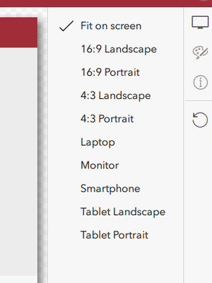

The preview setting in Connect (see below) doesn't really do anything. That is purely there so you can get a general approximation of what a survey will look like on that sized screen. Connect displays what you will see in the S123 Field App, NOT a web browser.
Web browser's have different navigation displays and other limitations - this isn't something you can change. If you are unfamiliar with these limitations, it may be easier for you to design the form in the web interface. You can go to the Surveys Site and click + New survey to design a survey in the web interface.
