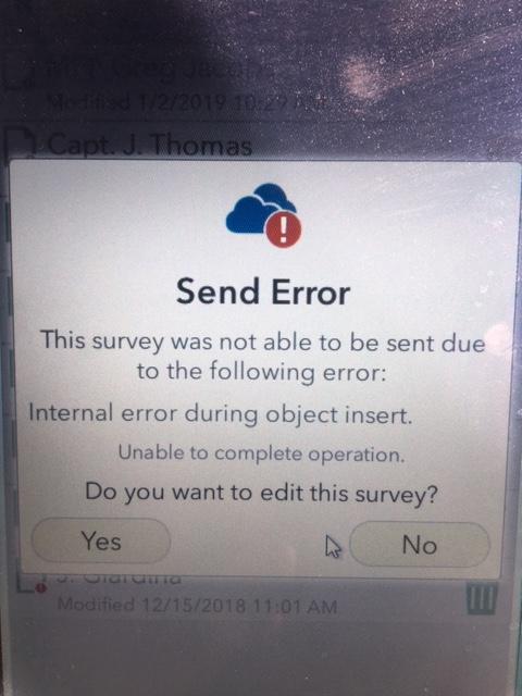

Let me see if I can explain this and I apologize if its been asked before:
When 'batch' sending surveys from our MDT's - the guys will go take the surveys then bring back the MDT and the information will be uploaded by me to the map - I have come across the following error screen:
I hit yes, review the entry and attempt to resend and receive:
"Getting service information"...  then nothing.
Has anyone come across this before?  I am using Version 2.7.98

Hi Thomas,
Has this workflow worked for you in the past, when did it stop, what version or changes were made? I see you are using an old version of Survey123, the current released version is 3.1. Also, are you using AGO or Portal, and have you recently updated the survey or republished the survey with changes to the feature layer?
Can you try and re-download the survey on the device (do not delete it first just re-download), and then try the fix database option available in Settings -> Storage (see below). Do not select reinitialize database as this will wipe the database on the device and the collected surveys that have not been submitted.
Let me know if that doesn't work and please provide more detailed information requested above.
