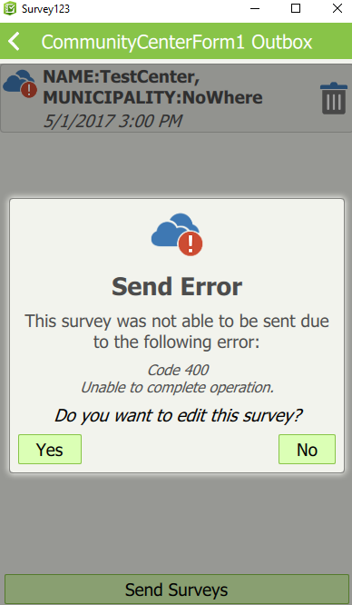

In Survey123 Connect, I have chosen to create a new survey, selected from a Feature Service, and chosen the secured service that I registered in AGO. The survey is created and published without issue. I downloaded the form onto Survey123 for Windows and started collecting a new survey. When I attempt to submit the survey, I get the following:
Send Error
This survey was not able to be sent due to the following error: Code 400 Unable to complete operation.
Has anyone encountered and resolved this issue? What is the cause? What is the solution? Is there specific documentation, step-by-step, that exists describing how to generate a survey from a feature service using ArcGIS Online and a non-federated AGS, from start to finish?

Hi Kyle,
Can you provide a copy of the Feature Service's REST JSON?  There are some specific requirements, like the service needing GlobalIDs.

Hi Kyle,
Yes, this what I was looking for- the GlobalIDs would be an issue.  See Mitchell's comment below- support for non-hosted services was only introduced with 1.10 in December

While this might not be causing this problem in particular, I do want to point out that it appears your version of the Survey123 app is quite old (I'd guess it's a version from before last year's UC, since that's when the UI was updated). Updating would give you a lot of added support, especially if your version of Survey123 Connect is more recent as well.

Hi Phu,
Can you share the XLSForm used to author the survey?  Also, can you provide a screenshot or the JSON of the feature layer's REST endpoint?

Thanks Phu,
There is an issue currently with Survey123 and Portal field names - the field names need to be lower-case.  We're working on fixing this in a future release.
