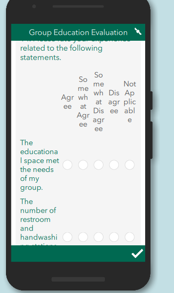

We've recently noticed that the Single Choice Grid's Choice Columns or Choice Rows does not expand for the length of the questions/options on mobile devices therefore it breaks the words in the question in funky places. Please see below.
This is what it looks like on the web:
This is what it looks like in S123 Connect:
Is this something that has been reported/ you plan to fix?

Unfortunately, it looks like your webform photos did not get uploaded successfully.  That being said, mobile devices present a more constrained spacing environment; at this time there are not plans to address column widths for single choice grids.

Hi I'm wondering if there's anything that can be done about a discrepancy between the preview view and the live view of a survey. While in preview, the Single Choice Grid looks fine. But once it gets published, the row height gets truncated and you are now unable to read it fully.
Suggestions?
