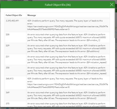

I am trying to export a custom report with 112 records.  It works fine with other queries but when I export this one i get a success rate of less than 70 percent.
I attached the details of the failed object here.
IsmaelChivite
Esri Notable Contributor
Hi. The ArcGIS REST API call quota is set by ArcGIS Online. It is unlikely that the Survey123 report service is causing such a large number of queries. It is possible that other clients are hitting your layer. This issue should be investigated by the ArcGIS Online team. I suggest you open an Esri Technical Support incident for this.
