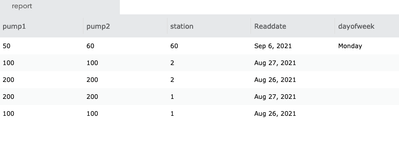

Since I don't really see your survey, please take a look at my syntax and table.
Here is my syntax in a summary section in feature report :
${Form_14 | stats:sum, pump1”|where:”dayofweek=’Monday’”}
My goal for this syntax is to sum up the value for  pump1 when it is Monday.
Besides syntax, I think it could also help you to understand better if I posted my table for the summary report as below:
Give it a go to see if this can help you.

Ah, looks like you calculate the day of the week into a separate field in the survey form? I was hoping to run that on the fly in the summary using the SQL DATEPART() function
