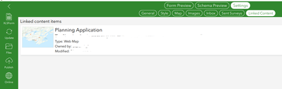

1. Add it in the linked content

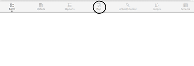

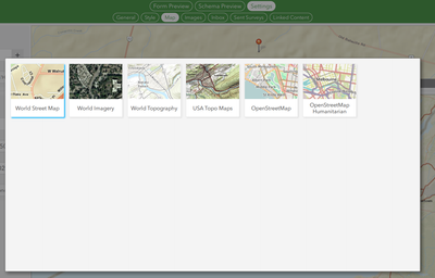

2. In the Map tab, click on the basemap gallery icon and select your web map:

I've linked a map from AGOL but it doesn't show up in the list of basemaps. Also tried to use the map id from the url which hasn't worked for me yet either.
