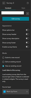

GISAdministrator_LMCC
Also getting this error in Experience Builder online, using the Survey123 widget to view previous survey submissions. When editing previous survey submissions, it works fine.
There's no option for me to change which version of the form is displayed, as there is no URL to edit.
