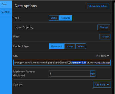

I think I figured it out. Check the settings for the embedded object. For me, I had it set to latest. I went back and changed it to my current version of Survey123 Connect which is 3.14. I reloaded the page and it works fine now.

Just a hunch but open your form in the survey123 website and click settings. What happens if you set it to either one of these options?

Just tried inputting the "version=3.21" parameter into the survey URL and that did fix the issue (for now).

@SteveMartin__MDTA_ yes thats it must be some browser update or something throwing it out i reverted back to 3.21 and it works for me now.
