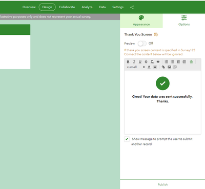

I don't see a way to configure the Survey widget within Experience Builder to do what you're looking for, but you could use the Embed widget instead and enable the "Show message to prompt the user to submit another record" on the Design tab for your survey in the Survey123 website.
These settings do not carry through when you use the Survey widget, but it looks like they do when you use the Embed widget.
