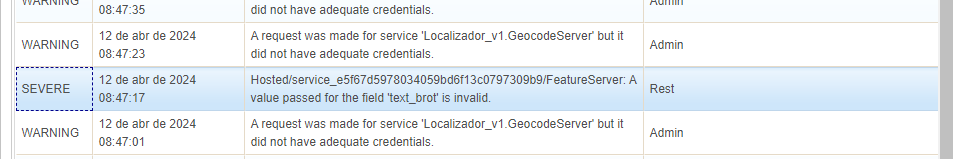

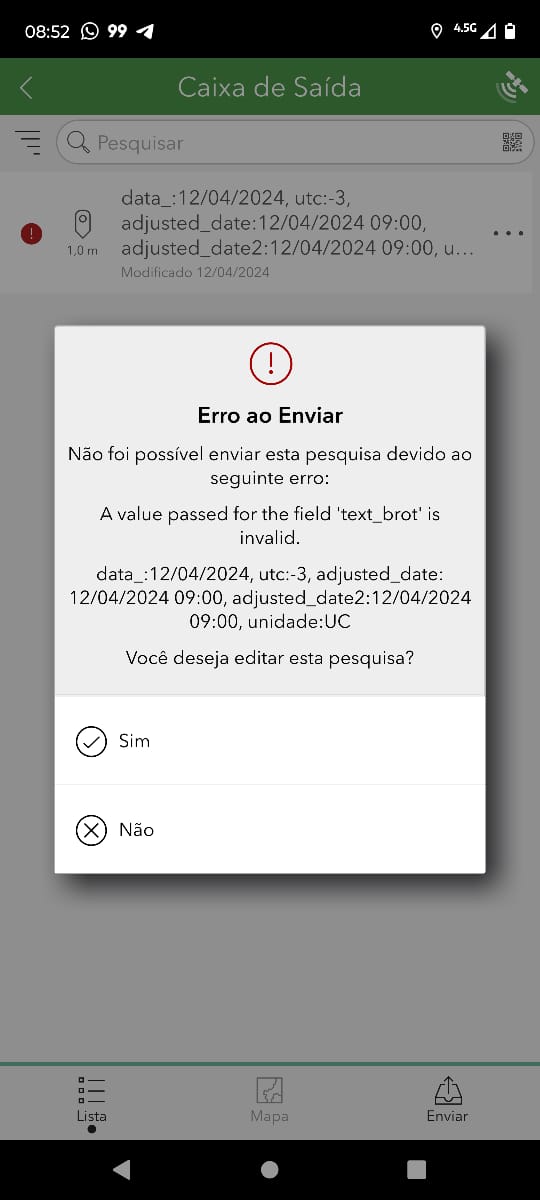

However, during testing of filling in the application, when sending the responses, I received the error “A value passed for the ‘text_brot’ is invalid”. To resolve this, I checked the formulas in the calculation column and they appear to be correct. I also checked the size of the string, which only contains the words “good” and “bad”, so it shouldn't be a size issue.
