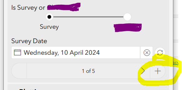

I have a survey that from inbox allows to record the edits every time the survey is open on inbox.
I enter "New Edits" on this day and a calculation in the main layer calculates the total number of days.
To have all previous days counted and also the ability to add new edits every time I need till the completion of the process, I added "query allowUpdates=true to the bind:parameters.
this allows me to calculate the days and hours,
It works, but the first record visible is the first imputed.
Since there is the risk of editing an old entry, is it possible to have an empty repeat on opening without the need of pressing +.
How can I have the all edits visible but not editable? and be able only to add a new repeat?
Thanks!
abureaux
MVP Frequent Contributor
"Since there is the risk of editing an old entry, is it possible to have an empty repeat on opening without the need of pressing +."
Short answer is "no".
"How can I have the all edits visible but not editable? and be able only to add a new repeat?"
Unfortunately, you cannot set "read only" for that field since it would work for both the previously entered data and the new empty data.
