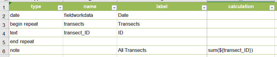

IsmaelChivite
Esri Notable Contributor
This may do the trick.
LynnBerni
Hi Ismael,
That worked! This gives me a simple list (eg. ABCDE) which works just fine in this case since the transect ID's are a single letter. For future reference, is there a way to add other characters (spaces, commas, etc.) between the values to make the list more legible? If these were anything other than a single digit, this wouldn't really work.
Thanks!
Lynn
