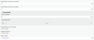

Basically I made a list of all the floors visited and passed it to a JavaScript function to remove duplicates, sort the floors entered, and comma separate the list:

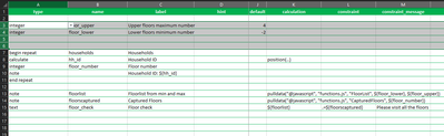

pulldata("@javascript", "functions.js", "CapturedFloors", ${floor_number})
Where floor_number is the floor entered into your repeat...
function CapturedFloors (floors)
var uniq_floors = [...new Set(floors)];
var sort_floors = uniq_floors.sort();
return sort_floors.join(",");
Next I used the floor numbers indicated to create a similar comma separated floor list:
pulldata("@javascript", "functions.js", "FloorList", ${floor_lower}, ${floor_upper})
I would then compare the two lists with each other and they should be similar when a fieldworker has visited all the floors of the building:

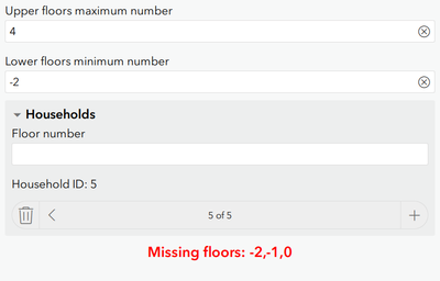

Now you can just call one function to retrieve the missing floors and show them in red:
pulldata("@javascript", "functions.js", "MissingFloorList", ${floor_lower}, ${floor_upper},${floor_number})
Show it in a note field with HTML formatting:
<div style="text-align:center; font-size:large; font-weight: bold; color:red"; >Missing floors: ${missingfloors}</div>

Hi
I accepted your challenge (in part) and came up with one possible solution:
Hopefully your survey is not a public survey, then you can use JavaScript to achieve your requirement:
I'm not sure if you will have a floor zero but in any case, your solution could be similar.
I hope this helps!
newwollyka
Great Solution.. Thanks for that.
I think the second function should named FloorList (floors) and its definition should be different.
I guess something like the below
function FloorList(lower,upper)
let arr = [];
for (let i = lower; i <= upper; i++) {
arr.push(i);
var uniq_floors = [...new Set(arr)];
return uniq_floors.join(",");

Btw, Is there a way to highlight or put in a note just the missing floors?
EDIT: I enhance your codeimage.png
