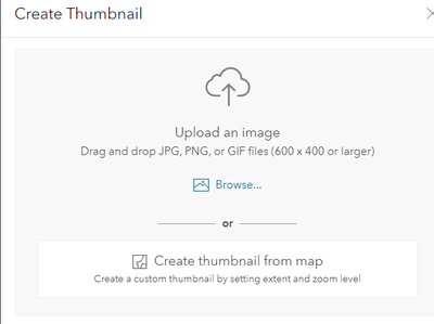

In AGOL it tells you to use 600x400 for a logo but I cannot find a number for 123.  This size seems ok so far but I just found that AGOL is not consistent so I wanted to check.
Everything in AGOL is
Except groups are 400x400 for some reason.
Makes it hard on the graphics person.  Thanks
