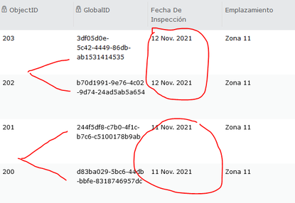

Fernando_LuisRodríguez_Valle
Hi Phil,
Efectily , the duplicate register has a diferent global ID.
I share the screenshot
I compared the data and attachments of both records and they are identical but with different Global ID and therefore all the data was sent but the application not having confirmation issued the sending error as you had informed me.
In my opinion in these cases, it would be great if the application could double-check that all the data was sent before sending an error message on sending
