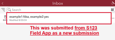

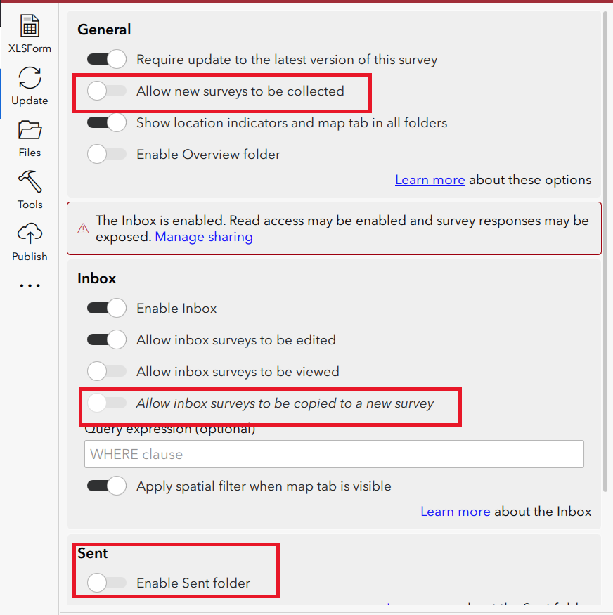

I have a survey where the "Sent" folder is disabled, the "Inbox" doesn't allow new submissions, and "Allow new surveys to be collected" is disabled. This means you can only edit what is already in the Inbox. However, when you download a survey, it ignores these settings and opens as a new survey, thus allowing submission that should be denied.
Now that I've clued in on this behaviour, it's rather concerning. While I don't see my staff intentionally submitting data this way as it would make zero sense, they technically could, which would introduce bad data into a very specialized workflow.

EDIT: Forgot to add a setting to the list. Here is a screen cap of setup:

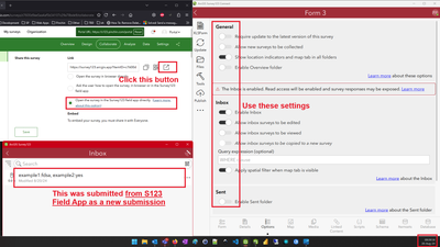

I just recreated this again. This appears to be "normal" app behaviour. And considering the settings selected in Connect, 100% unintentional.
Every single time you press the "launch" button, it takes you into a black survey form that can be submitted, despite the fact Allow new surveys to be collected is toggled off.

Not silly at all! Honestly, the first time I saw this behaviour I thought "well maybe it will fail to submit and I'm just overreacting".
So I gave it a try, and indeed, you can submit. I tried to include that in my last screen shot. This is a picture of the S123 Field App's Inbox for the test survey I just set up this morning. This submission in the Inbox was sent from a survey where "Allow new surveys to be collected" was toggle off.
EDIT: And as I mentioned in my original post, this isn't a good thing. I have a very controlled survey where submissions can (or at least should) only be added by a detailed automation process. This strange workflow being possible introduces a liability that I will need to account for now.

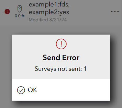

I disabled that:
Tried again... and was able to submit.
I am using an admin account though, and there are some operations that admin accounts ignore layer settings and let you do anyway. So, I set up my personal account as Data Editor and tried again. Finally got my Send Error!
So you still need to be careful of your admin accounts, but at least Publisher/Data Editor accounts can be blocked from sending.
