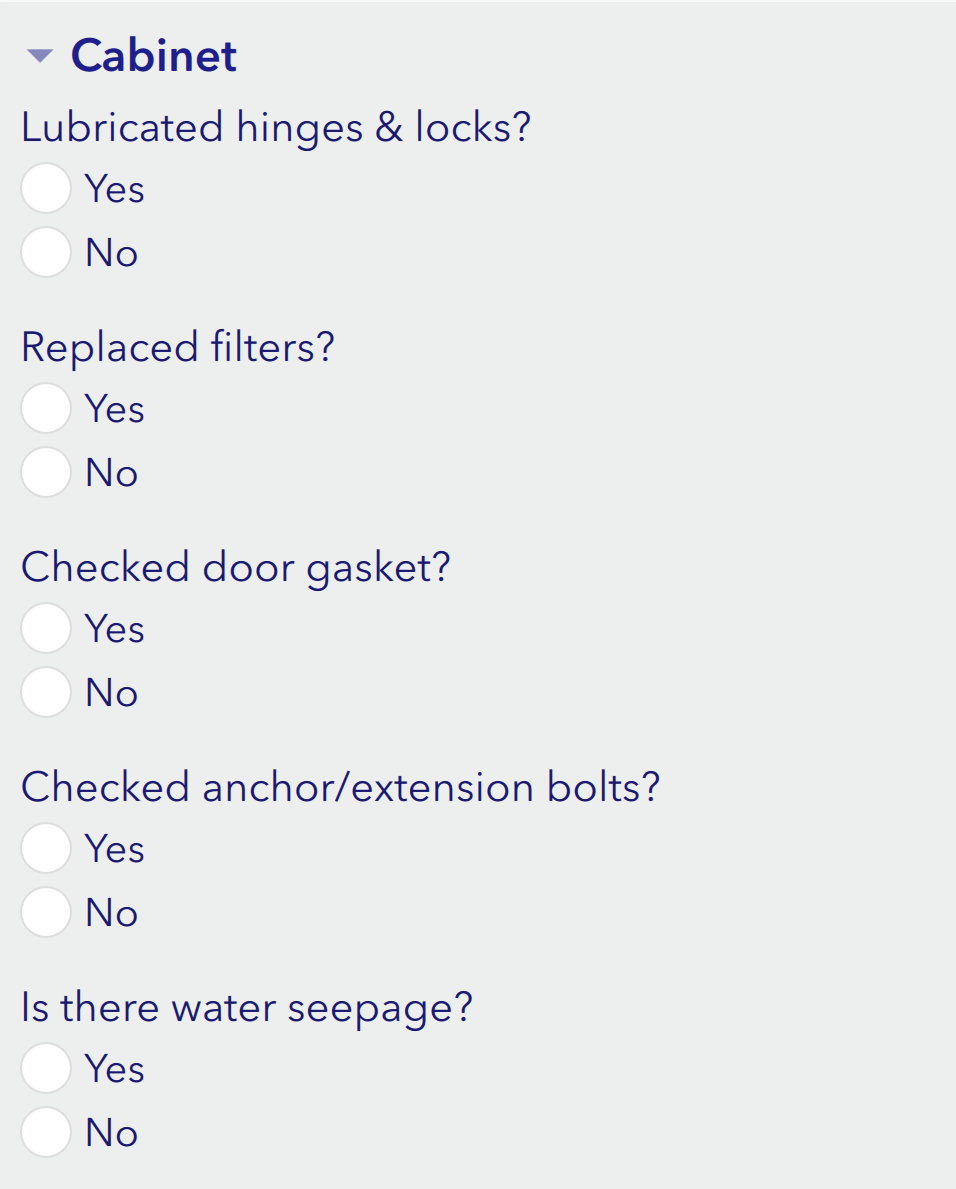

I am trying to find out if anyone knows of a way to use Survey123 Connect to create simple checklists for traffic signal preventative maintenance inspections?  I originally made the technicians and yes/no form but since they are testing it on cell phones, they asked if there was a way I could just make a checkbox list so they didn't have to scroll through all of the sections of questions which takes a lot longer for them to get through.

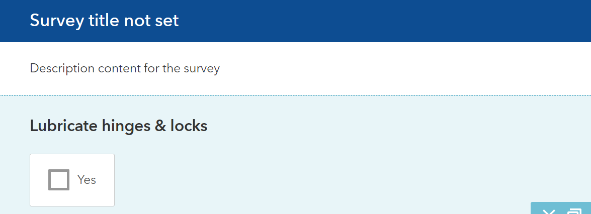

I looked around online and didn't seem to find anywhere that I could put "checkbox" as a single option for "yes" on their questions and I'd prefer to use Survey123 Connect if possible.  I did try it in Survey123 web but wasn't happy with the way it looked and didn't see anyway to customize it there.

Original form created in Survey123 Connect but too long for field techs on cell phones:
Non-preferred attempt in Survey123 web app:

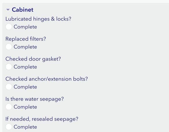

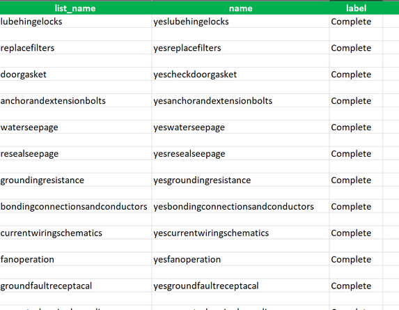

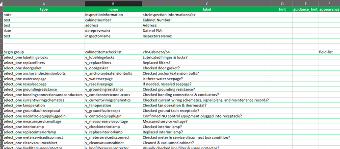

Thank you Jose.  That doesn't seem to be working for me.  Is it because I only have one option?  I've included a sample of my spreadsheet and what it looks like in Connect after saving.  (I did change the 'yes' to completed since they just want a checklist to mark each item once their task is completed).
Excel Table Survey Tab:
Excel Table Choices Tab:
Connect View after changes:

Based on my very quick glance, you are using field-list rather that table-list for your appearance.

Sorry. I had a feeling something else was off and had another quick look. For your choices, you should only have one option:
list_namenamelabel
completecompleteComplete
Your current set-up is pretty redundant. Change all of your select_one to select_one complete.
Everything else should be okay.
