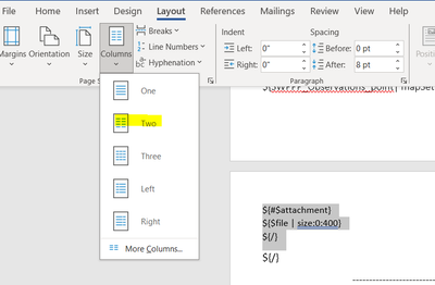

EmmaHatcher
I found a workaround to accomplish this! You can highlight your photo attachment repeat lines in your report template Word document, including the repeat header and closer lines, and then format your layout as two columns. See pictured below. I tested on 4+ photos and it consistently stacked them in columns without affecting the rest of the report.
