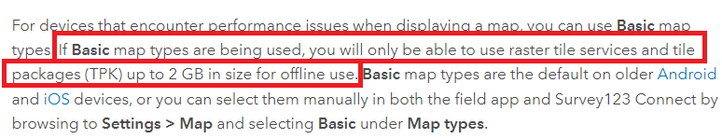

Not sure about why this happens, but I am now assuming it has to do with the file size:
The documentation mentions it:  Prepare basemaps for offline use—Survey123 for ArcGIS | Documentation
I am having the same issue so frustrating!! Anyways hope this helps someone
