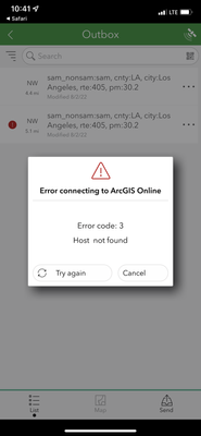

This is a message I am getting:
Any suggestions you may have would be appreciated.
