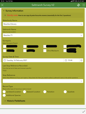

Here is the survey as it appears on the screen... as far as I know it is a one element array! (or at least that's how I was treating it in the jscript!
The issue is the note..."Last Stop Reference Recorded" This is the info the Javascript gets from the hosted feature layer denoted by the script attached in the first post. I know the rest of the survey works ok as I took out the Script and the two rows from the xls form....

I have also attached the info from what i call the 'instance window' when pressing the submission on connect (if that is any help)!
The pulldata("@javascript"...) was set to esriFieldTypeString and field length of 4000. I tried removing these to see what would happen but it still didn't work.
I am a bit lost what to do now?
