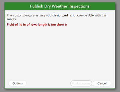

When I adjust the field lengths (all 255), I am unable to publish the form. The error only occurs on text fields, not select_one fields. When I match the field lengths to the table counterpart in AGOL, it publishes just fine.
