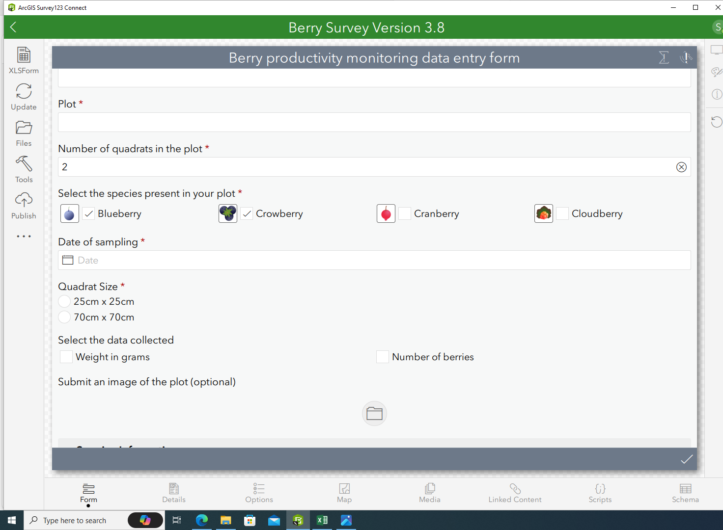

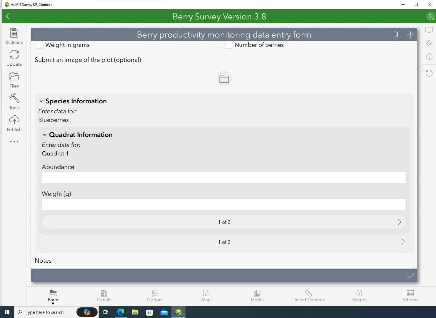

I am trying to use selected-at to force user to enter data in a certain order.
At the beginning of the survey, the user is asked which species were present at the site and how many quadrats were sampled. Based on these answers, a set number of nested repeats appropriately labeled are generated.
The calculation uses the position within the repeat to assign species ID and Quadrat order. It works fines in the field app and Survey123 Connect, but the web form does not recognize the result of the calculation.
See screenshot in Survey123 Connect and attached xls. The issue happened in both repeats at line 27 and 34.

Note nested repeats can be funky in the web.  I see they now work for new records but not edits.
I think it may be you have a field named count but that is a reserved word. See the Reserved tab in the xlxs.  Web is a lot more picky about that.
Be aware make sure to test a user going back a few repeats and deleting a record, then adding a new record at the end.  It will dup your numbering.  Not much you can do about it.  We tell users to not do that.  If they need to make a change just change it do not delete.  We still get them sometimes but really we dont worry about numbering as much anymore as we don't really use it for much in newer systems.  I am also not sure how this will work with repeat_count.  I gave up on using it since it preloads all repeats at the start, which broke a lot of my calcs.  But it may negate the delete issue not sure.

Unfortunately, changing "count" for a non-designated term did not make it work in the web form. We need the nested repeats to summarize data by species unfortunately. I will use your duplicate check trick instead with a drop-down list.
