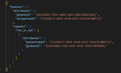

You need to use a combination of fields.
uniquerowid/RowID (parent) > connects to the parentrowid/ParentRowID (child). Keep going down this line for nested repeats.

This can be fairly quick in Excel with something like index(match()), but I haven't had the opportunity to try in ArcPro myself yet.
I believe this person has a similar requirement/setup to you.
