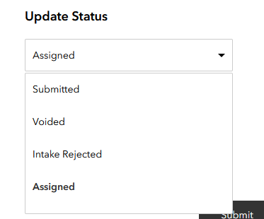

When I configure a select_one field that is populated using the search function, when published, the style of the drop down is autocomplete, no matter which style options I configure.
As an example, I have two select_one fields. The first one is populated from the values in the choices tab. The second one is populated from a feature service. Both have their style set to 'minimal'
Within the Survey123 Connect app they both look correct as simple drop-down boxes.
When published, the first one is styled correctly as a simple drop-down. I can see all of the options when a value is selected.
The second one is styled as an autocomplete text box. If the field is not populated, it's okay because the user can see the available options (although I do wish the styling was the same).
If that field is already populated the options are filtered by the text. So it isn't clear that you have to clear out the box to see all the options.
Even if I choose a completely different style, like "compact", it is styled correctly in the app, with multiple horizontal radio buttons but is autocomplete when published.
