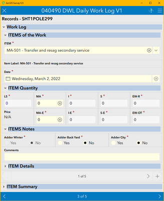

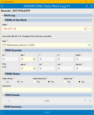

I have hit a new issue with 3.14 where an select_one appearance autocomplete from an external choice list inside a repeat in a survey from the Inbox will show the proper label for the first record in the repeat, but shows the name for the subsequent records in the repeat.  It highlights the name in red italics to indicate a wrong entry, but it is not an error and behind the scene everything keep working including other lookups related to the name.  As a work around for this survey I pull the label based on the name below so the user knows what they are selecting...  Or you can turn off autocomplete.  Screen below are record 1 of the repeat followed by record 2 of the repeat.   I have this issue in roughly 60 surveys. Thanks, Larry

  • open the survey from the Inbox and step to the second repeat record, the name will be displayed in red instead of the label for the Photo Type.
