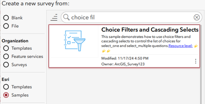

EDIT: There is also an Esri Sample built into Connect for choice filters, in case you didn't know to look there:
