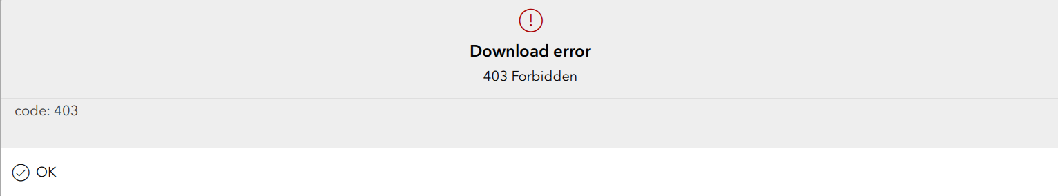

I just came back from leave and I can no longer create new surveys, both on advanced template and standard template.
I get this error when trying:
I reached out to our IT department to see if a firewall blocked the downloading of the template, but they told me no.

Found the problem in the error log: blocked link was different from the one the post I cited was calling.
Unblocked that link and everything works fine
