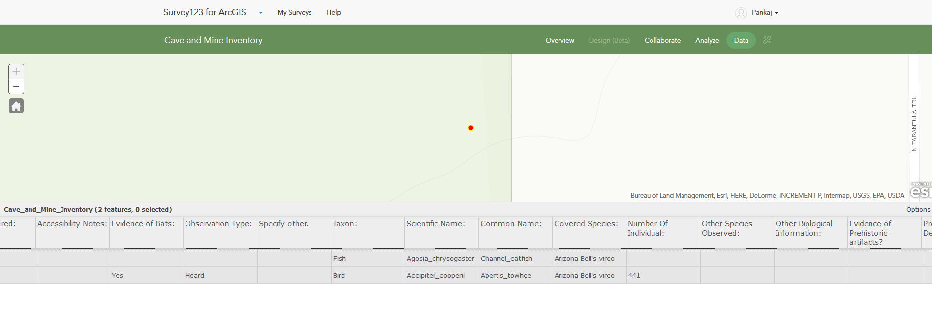

Thanks Mitchell for your reply. I entered the Scientific names in the name column, separated by underscore.SN2.PNG
