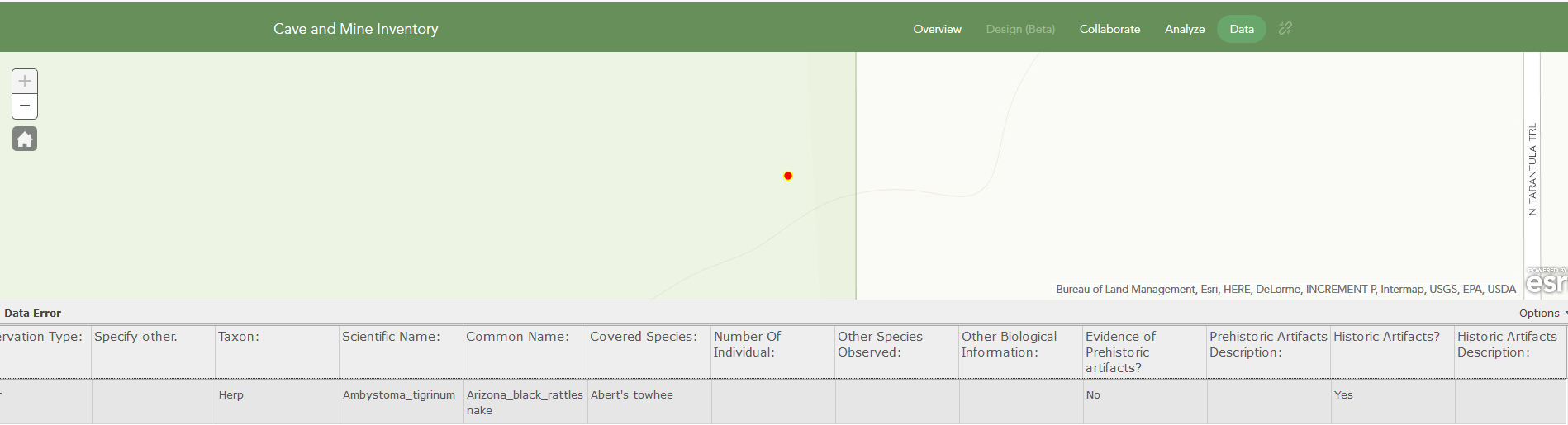

I have another question. I want to record Scientific Name of the species in the geodatabase but in the name column under “choices”, the Values (in our case Scientific Name) do not accept spaces. There should be a gap between first name and the last name. So, is there any way I can separate the first and last name in the geodatabase? I entered the Scientific names in name as well as in label column but still scientific names are not separated in the downloaded FC. Is there any solution for that?SN2.PNG
