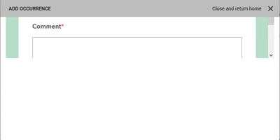

The Survey123 web form (embedded in a model dialog in a VUE app) is cut off and the user has to scroll within the limited portion of the window

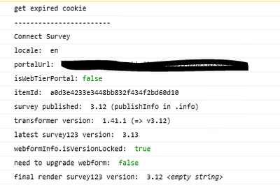

It happens across all browsers - but was displaying correctly yesterday. The underlying code has not changed. I have republished the survey with 13.12 but that has had no effect.
Additional info:

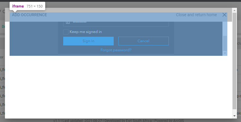

The i-frame created by the Survey123webform is restricting the height of the survey123 content to 150px even though the container div is set to height:100%

Hi @Dawn ,
Are you using web app js api to embed survey123 into your own app? If so, to keep the embedded survey working, I would suggest to listen to onFormLoaded and onFormResized events and set the height of the iframe dynamically, for example: https://codepen.io/nan9266/pen/gORxvBw?editors=1000
There has been changes, therefore, give the example a try and see if this would work for you.

Dawn
Thanks Alison
That change has worked on our Dev version
