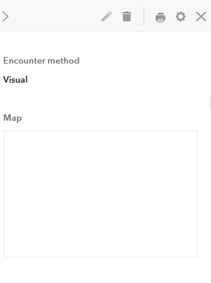

When viewing Survey123 results via the Survey123 website (survey123.arcgis.com) for one of our forms, we have recently noticed that the geopoint locations no longer appear in the Form view (Data tab). Instead, where the map would normally appear it is blank. This is not the same across all of our Survey123 forms.
Screenshot showing an example of the blank map:
Points appear to be displaying correctly in the main map window - just not the Form view.

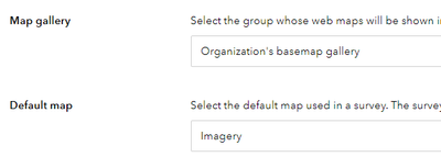

1. login survey123 and find Organization (my surveys) ---settings, you would be able to see Map gallery and Default basemap, thats base map gallery used in map question.  Survey123 pulls Map gallery from your organization.
2. login to your organization and find the basemap.  After login, go to Group -- my Organization's Group, paste name of Map Gallery you found in Survey123 to search and you should find it.

Hi @alison_gou ,
Thank you. I have followed your steps.
1. The Survey123 Settings shows the map gallery as 'Organization's basemap gallery' with 'Imagery' as the default map.
2. When I search for 'Organization's basemap gallery' it returns 0 results. I do not have a group of this name.

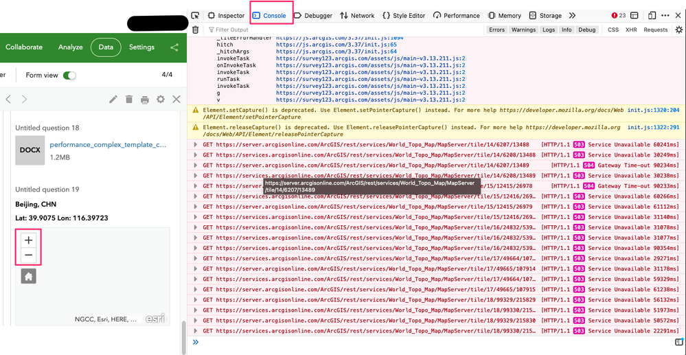

Hi @DataOfficer ,
There are two more tests you can do.
1. Survey123 3.13 just released today and you may open your survey with new version to see how it goes;
2. If still not working, follow steps below:
  •  Open the Data page of which survey goes wrong.
  • Open developer tool  and click on 'console' to observe and capture errors.
  • Open form view and click on the zoom in&zoom out ( + and - button on the map) button on the map to see if there are errors.
I have a similar situation below:
