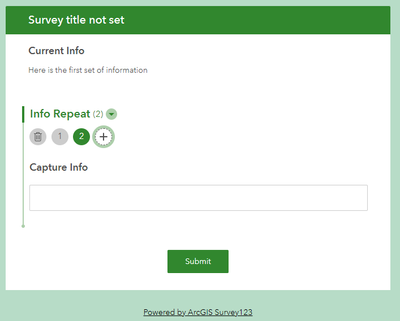

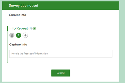

Information is entered into repeat:
Information enteredInformation entered
Populated after adding second record:
Populated after adding next recordPopulated after adding next record
