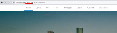

Hello @HanliePetoors
https://survey123.maps.arcgis.com/ is my ArcGIS Online organization and was an example of what the URL for your ArcGIS organization would look like.
If you log into your ArcGIS Online organization in a browser you can extract your organization URL from the browser URL:
Please note you don't need to enter the whole /home/index.html in Survey123, you just need the organization URL which in my case is https://survey123.maps.arcgis.com.

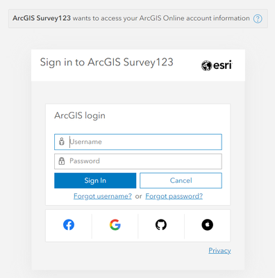

HanliePetoors
Hi @ZacharySutherby
Thanks for the reply.
I set https://survey123.maps.arcgis.com/ as the URL and used browser login.
When logging in I then get this form, which doesn't give the option for an organisational login.
I entered my organisational username and password but that failed.
Am I missing something?
Thanks
Hanlie
ZacharySutherby
Thank you,
Zach
