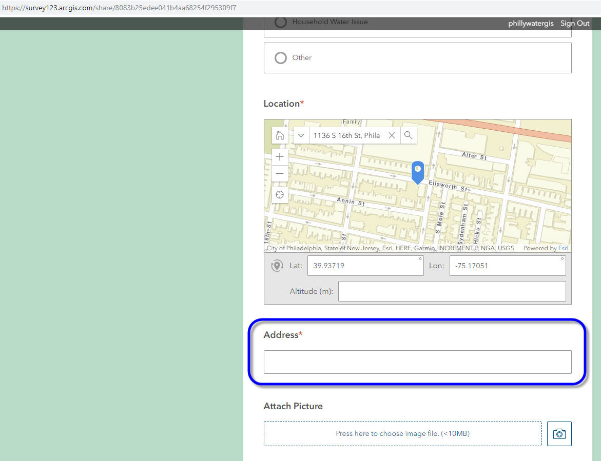

I am very new to Survey123.  I'm using Survey123 Connect to create a survey to be used in a browser.  In my XLSForm I have a text field with a Calculation of pulldata("@geopoint",${location},"reversegeocode.address.Street").  Our default geocoder is hosted by us, but is publicly available.  I can see the results returned to this text field in Connect, but not in a web browser.

but not in a browser:
Has anyone experienced this before, or have an ideas on troubleshooting? Thank you!
