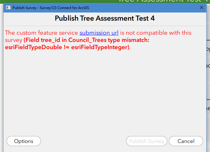

I'm following the above error when I try to publish my survey from an existing feature class:
I can confirm that tree_id is Integer in all tables.  Previously it was Double but I have since created a new field, new relationship, exported he data to a whole new geodatabase, published out to a new map, and created a new survey. Yet I am still getting this error.
Help!
Here is a snapshot of tree_id in Council_Tress which shows that it is indeed an integer.  ANd below that the relating table which also uses tree_id.

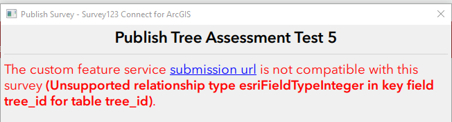

I've changed the bind::esri:fieldType as Doug suggested below but now it is complaining about Integer being unsupported relationship type.  I have the relationship working in Pro nicely.  The form appears without issues, its just on publishing I find this.

Thanks Doug.  I've changed this, but now it is complaining about Integer being unsupported for relationships.
JamesTedrick
Esri Esteemed Contributor
Hi Naomi,
When you republished, was the relationship between the feature class and table based on tree_id?  Survey123 only supports relationships based on GUIDs (either Global IDs or other GUID fields).
