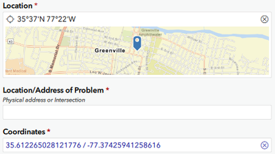

I've read through multiple posts about revere geocoding (long press on the map to auto-populate an "address" field within the Survey123 form).  I've tried over and over to get it to work, with no success.
If I enter:
pulldata("@geopoint",${location},"x","https://my company's geocoder URL")
I do get an X coordinate that auto-populates the address field.  If I enter:
pulldata("@geopoint",${location},"reversegeocode.address.singleLineAddressField","https://my company's geocoder URL"
I get nothing.
What am I missing/doing wrong?

Thanks for the reply.
My company's geocoder has a "Match_addr" field, but even putting that (reversegeocode.address.Match_addr) into the calculation doesn't return any results.
I've even tried takin the geocoder URL out and just used pulldata("@geopoint",${location},"reversegeocode.address.Match_addr"), and that doesn't work.  If I modify the "reversegeocode.address.Match_addr" to pull coordinates, it works.
