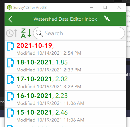

I am using Survey123 Connect. I am pulling in an existing feature service using Enterprise 10.6.1. The survey is using a table from that service. The problem I am facing is that the date is off by a day.
In the app the data shows today as tomorrow. In the image below. The data that is the 18th is today data in the geodatabase.

I need both these days to be the same. I think it is a UTC issue but I cannot figure it out.  I am in PST.

You have to explicitly set the time zone for the feature service. You're correcting in thinking that it is a UTC issue. The system assumes that it is UTC if you don't set it as PST.

How do I do this? I am using a table so I have to add a random layer just to publish the layer.
Edit:
I am publishing now with that change. I will let you know if that works.

That worked thanks!
