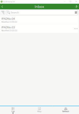

I added 'query' to the bind::esri:parameters column for the begin repeat row, and in options I enabled the Inbox... however it doesn't appear to work. I should note as well that when I view the inbox after enter a simulated 1 day collection, no records appear after I refresh. Clearly I am missing something?

@AKorsos No problem, are you not seeing any survey records at all in the inbox? Or is it just the repeat records that aren't showing up?
If you aren't seeing any survey records at all, you could check to see if the sent box is enabled too. If the surveys are in your sent box then they won't show up in your inbox.
If it's just the repeat records that aren't visible in the inbox, would you be able to share your XLSForm so we can take a more detailed look?

I entered a 'days' collection in the App. Closed the app and then went back in as if it was the next day and nothing appeared in the Inbox...

Thanks for the XLSForm, on initial read through it looks like everything is configured correctly in the form. If you look at the survey details page in the field app is there a sent box along with the inbox?
AndreasKorsos
Hi Barbara
Yes I have what you show. A Collect, Inbox, and a Sent showing 1 sent
Thanks
Andreas
BarbaraWebster1
In the field app a record will only show up in one of the 'boxes' at a time, so if you go into the sent box and press 'Empty' and then refresh the inbox, the record should appear in the inbox.
It's also possible to disable the sent box in the settings in Connect if you only want to access records from the inbox.
AndreasKorsos
Hi Barbara
I did both. Left the Sent Box and then turned it off. I was able to see the items in the inbox after a refresh... unfortunately the count still starts as 1 again after restarting the survey rather than recognize the count in the inbox. It is almost as if the 'query' is not looking at the inbox. Did you use the form that I provided to see if it worked on your end?
Thanks
Andreas
BarbaraWebster1
I tested out your form and the count calculation is continuing from the last count. I included a GIF of what I'm seeing when I have a record that has two previously existing repeats. Are you seeing the previous day's repeats when you open the record from the inbox?
